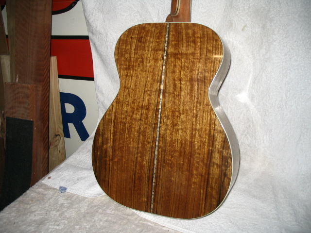

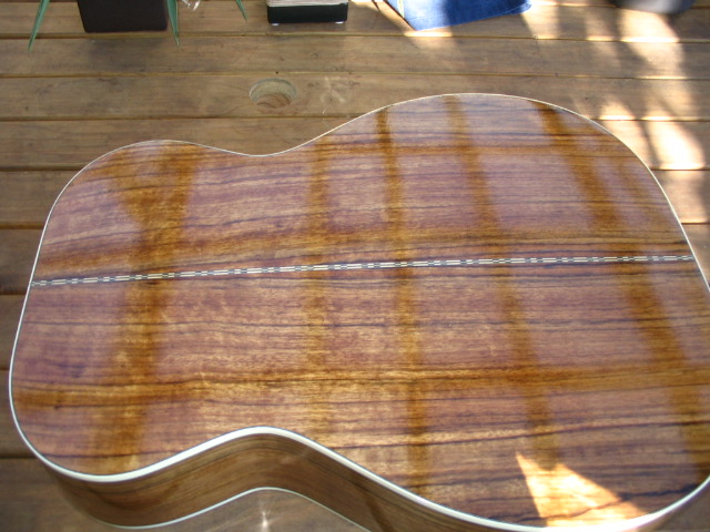

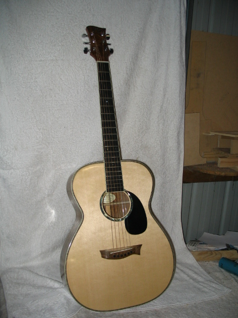

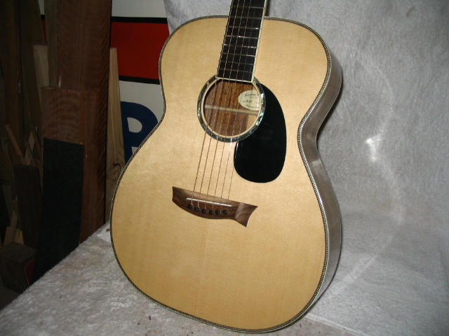

Dave is off to Wales on Wednesday to visit family and friends and this OM is going with him as a surprise gift for for one his mates who taught him how to play guitar when he was a little tacker.
It's also the reason I haven't got the recordings done of the other two OM's as we've been battling to get this one ready to go.
Specs
Back and sides - Ovangkol
Top - Sitka Spruce - Parabolic braces
Neck - Mahogany/Maple/Blackwood
Bindings - Ivoroid
Pickup - K & K mini Western
Body Finish - Ubeaut Hard Shellac
Neck Finish - Briwax
It's a nice, simply adorned and sweet sounding instrument.

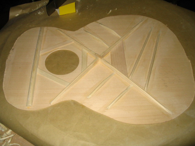

The top is quite thin - 2.2mm/.086" but we've been tending that way on the OM's.
Ovangkol is a delightful wood to work with but it stinks.
Thanks for looking

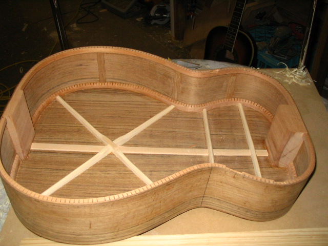

And some construction pics.
